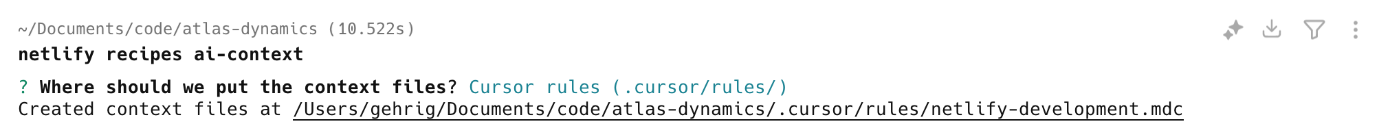

Here’s how this works with Netlify’s Edge Functions. Add context files to your codebase with the netlify recipes ai-context command:
Netlify CLI AI context recipes
