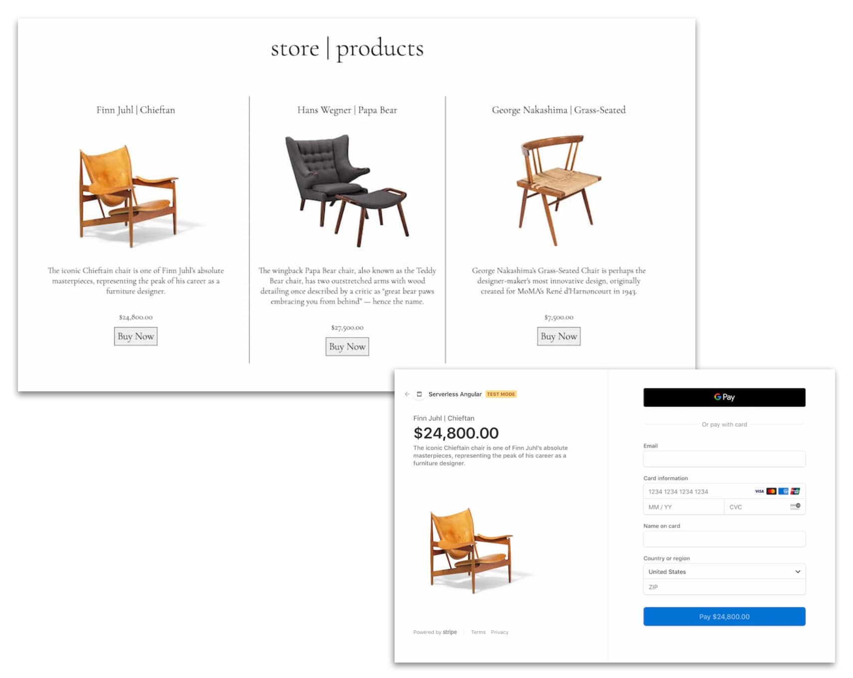

First off, here is what the end product for today will look like: a simple product page with ‘Buy Now’ buttons and the Stripe checkout page the users are sent to for making their purchase.
side-by-side picture of the final project

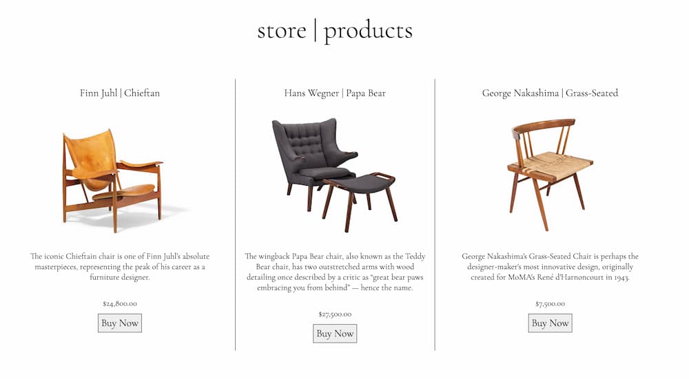

Here is what this page will look like:
a screenshot of the product page

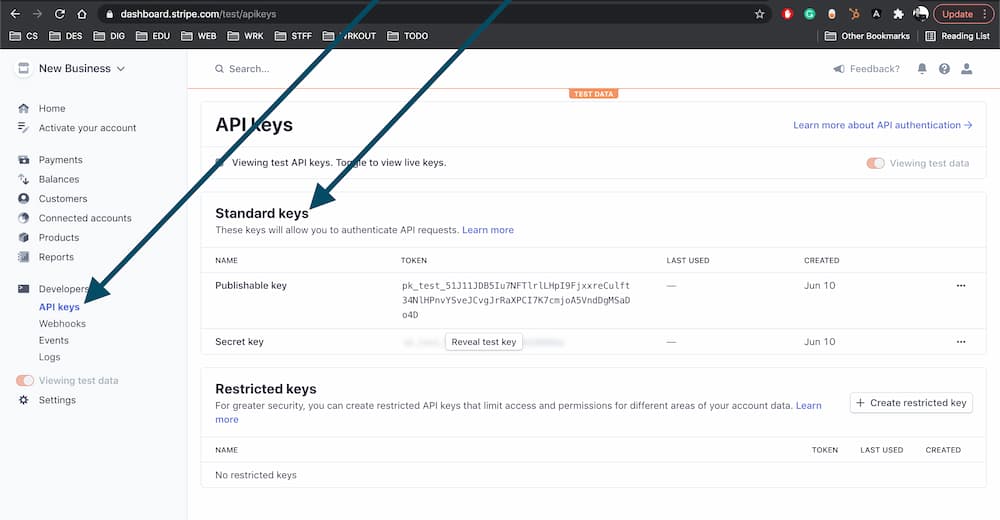

Grabbing Stripe Keys
On the Stripe dashboard at https://dashboard.stripe.com/test/apikeys, on the left-hand side under the ‘Developer’ menu, there is an ‘API keys’ menu. In that section, we’ll find the ‘Publishable key’ and ‘Secret key’ we need for this project.
Stripe API key menu
🚨 If you have an activated Stripe account and are just trying this out make sure you have ‘Viewing test data’ toggled on the left-hand side of the dashboard.

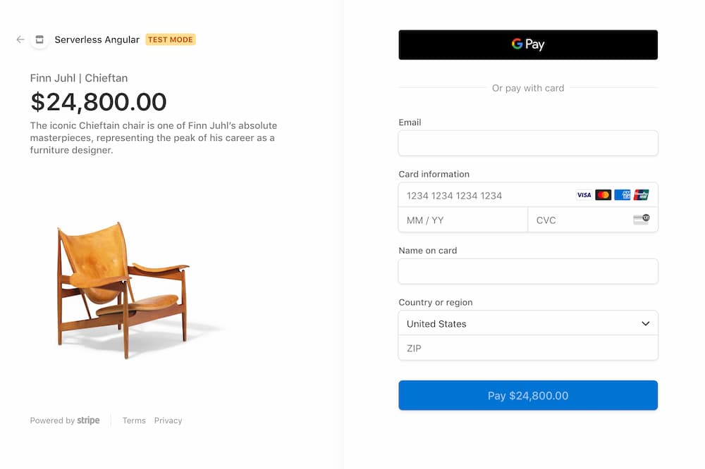

We can test it locally by running netlify dev or by pushing the new code up to the project repo (which would trigger a new deploy) and seeing how it works in the real world by going to the live site. Whichever environment, we should be able to click the ‘Buy Now’ button and be sent to the Stripe checkout process for the product clicked.
stripe checkout page for clicked product
