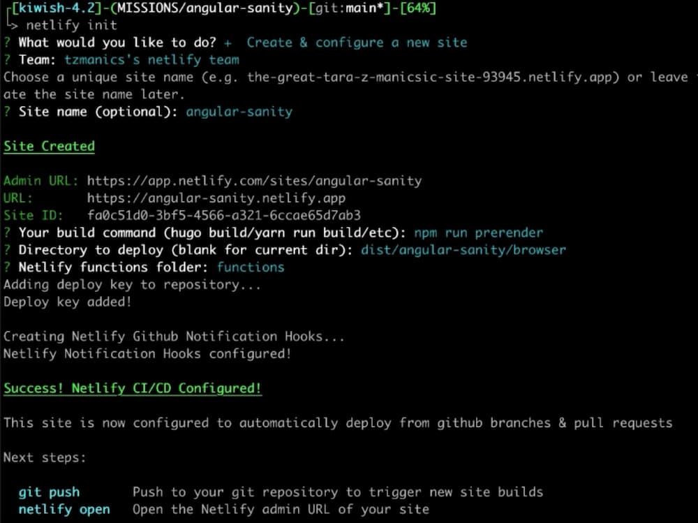

Deploying the Project to Netlify
We can now hook this site up to Netlify so whenever we push a new commit it will trigger a new deploy (CI/CD). Having it live we can see what our users will experience when they request the site. The template project already has a Netlify configuration file, netlify.toml. We can just run a few commands using the Netlify CLI.
npm install netlify-cli -g
netlify login
netlify init
First, we install the Netlify CLI globally (if we don't already have it installed) and log in (unless we're already logged in). The netlify init command will ask a few questions and set the command and publish settings with the project's netlify.toml file. This command will also trigger a deploy of the project. We can run netlify open to get to the project dashboard, to see when the build has been published.
netlify init output

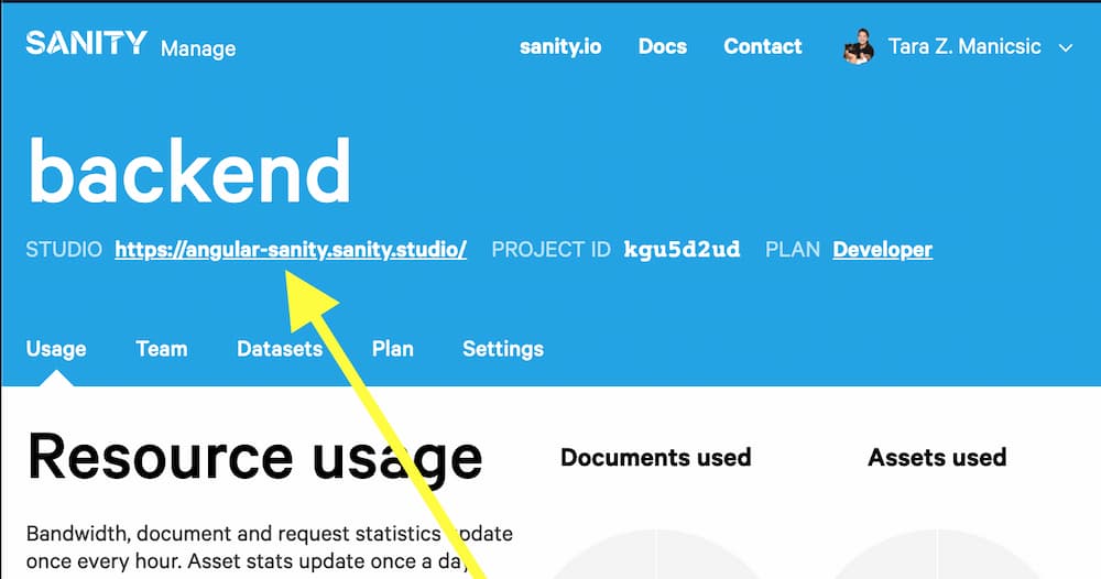

Deploying the Sanity.io Desk
Although we can host our Sanity.io instance on Netlify, I want to show the built-in way. From the terminal, we can run sanity deploy and it will prompt for a name then set the live instance at https://.sanity.desk. Once made, this information can be found at the top of the project page at sanity.io.
sanity.io dashboard
Anytime we want to update the deployed version of the Sanity.io instance, we'll need to run the sanity deploy command again.

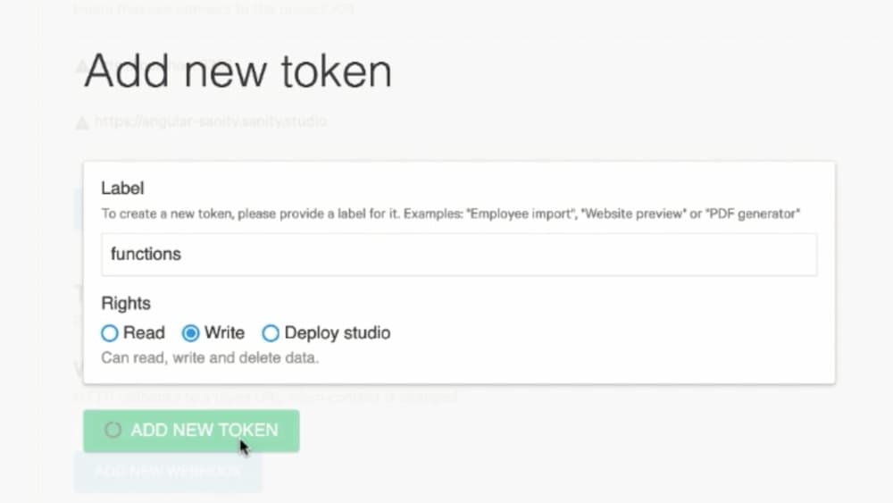

To connect to the CMS, we'll need to use some project credentials: the project id, dataset, and a token. We can grab this information from the project's dashboard. First, the project id is at the top of the page and we know we are using the 'production' data set. To get the Sanity.io token we'll go to Settings/API/Tokens and click the 'Add New Token' button.
Sanity.io project dashboard

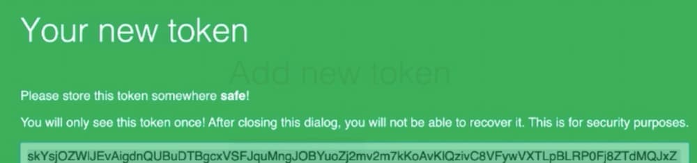

Then, we'll name the token 'functions' and give it rights to write (which includes read, write, and delete data). When we click the 'Add New Token' button, we'll get a token to copy.
creating a new token
the new token

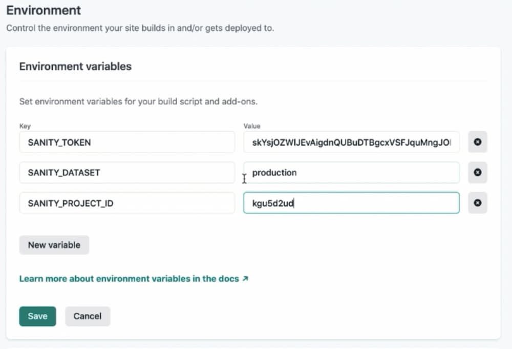

Next, we'll head back over to the project's Netlify dashboard to enter these values. Go to Site settings/Build & deploy/Environment and click the Edit variables button. We will add the following variables:
  • SANITY_TOKEN = (the token we just created and copied)
  • SANITY_DATASET = production
  • SANITY_PROJECT_ID = <your project id (e.g. kgu5d2ud)>
Netlify environment variables entry
