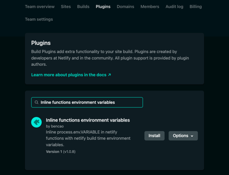

On the Netlify UI dashboard, click on Plugins. Search for “Inline functions environment variables” and press enter. Click the install button next to the plugin in the list.
A screenshot of the Netlify UI showing the inline functions environment variables in the plugin list

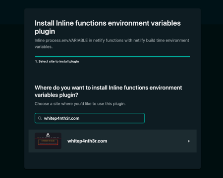

Choose which site you’d like to add the plugin to, and confirm.
A screenshot of the next step of the plugin installation process, asking where I would like to install the plugin. In the search box is whitep4nth3r.com showing the UI is ready for me to select my site.
