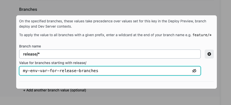

We now support configuring your environment variables to apply a value to groups of branches with a given prefix. Explore the new functionality in Site configuration > Environment variables. When adding a branch value for your environment variable, add a wildcard at the end to apply the value to all branches beginning with the prefix. For example setting the branch name to
release/*will apply the supplied value to branches namedrelease/1.2,release/alpha-0.0.1, and so on.Combine with the ability to configure your site to deploy branches matching selected prefixes to super-charge your branch workflows!

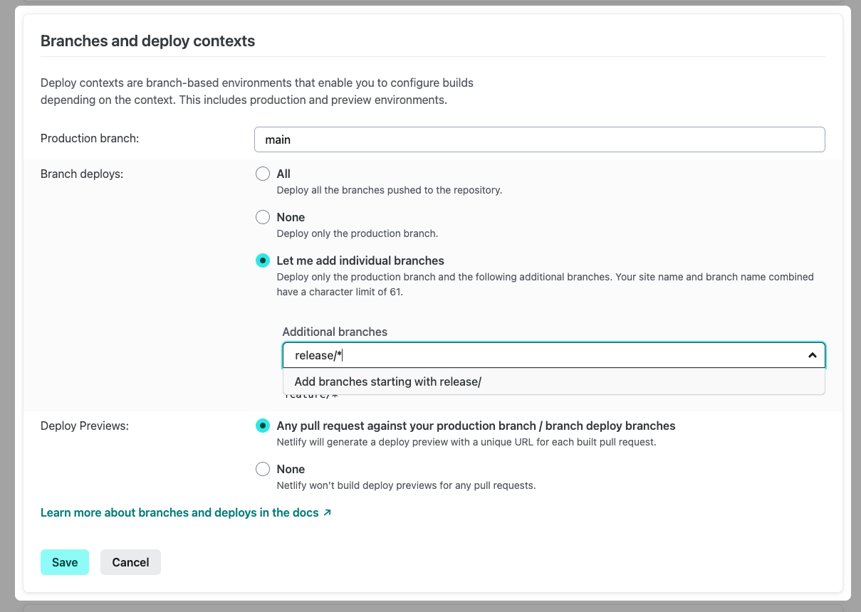

We now support configuring your site to deploy all branches with a specific prefix. Leverage the new functionality by configuring Branch Deploys in Site Configuration > Continuous deployment. Add a wildcard at the end of your prefix to deploy all branches beginning with the given text - for example, enter
release/*to automatically deployrelease/alpha-1,release/v2, and so on.
