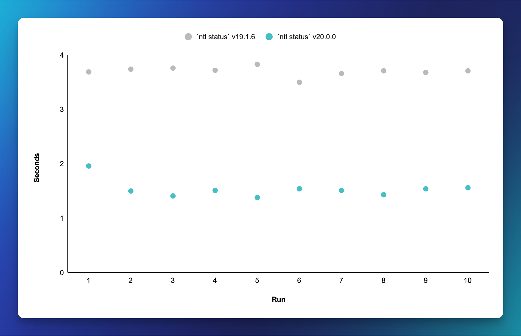

We’ve made meaningful Netlify CLI performance improvements in v20.0.0, making your workflow 2 to 3x faster with:
- ~400ms faster startup for every command
- >2s faster execution for most commands
- ~5s faster builds for Next.js apps
Get the latest by running:
npm install -g netlify-cli@latestFor an additional 10-15% performance boost, use Node.js 22.8.0 or later.
