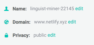

Log in to app.netlify.com and choose your site.
First, make sure that your custom domain has been set. The domain name of your site must match the domain name on the SSL certificate.
