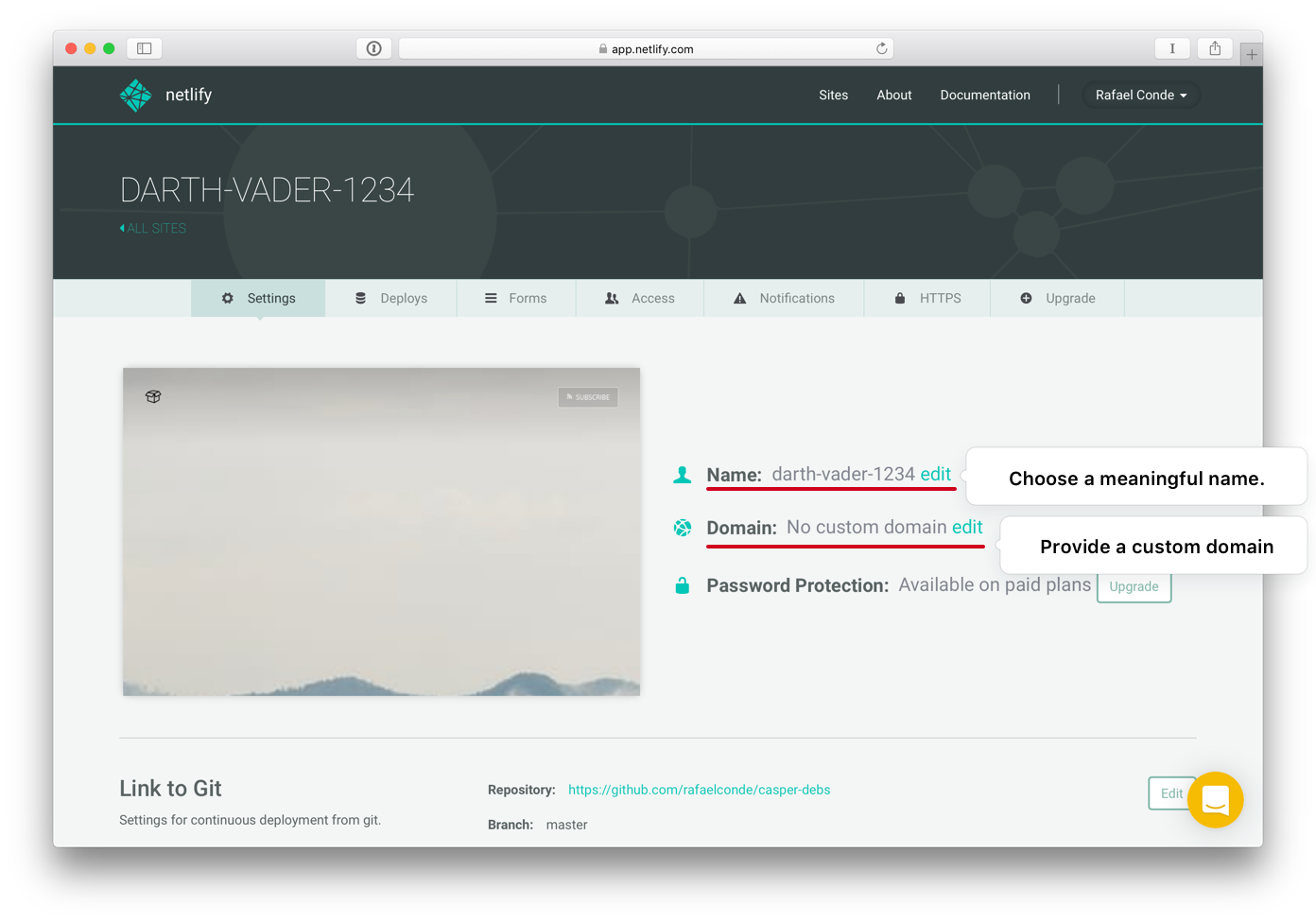

  1. Name your site something meaningful immediately. We pick an automatic name for you but it is just a string of words and numbers. You can certainly leave your site named magic-firefighter-12345 but if you run a few sites with us, they are pretty hard to tell apart. Pick a name that is a valid DNS hostname (all letters, numbers, and dashes — no spaces, symbols, dots, or underscores), and one that you don’t mind your customers knowing since it is visible to people who closely examine your site’s settings. I usually use something like “projectname” or “project-test”. You can change this later, but you will also have to revise some other settings when you do (see step 3 below) screenshot of settings page

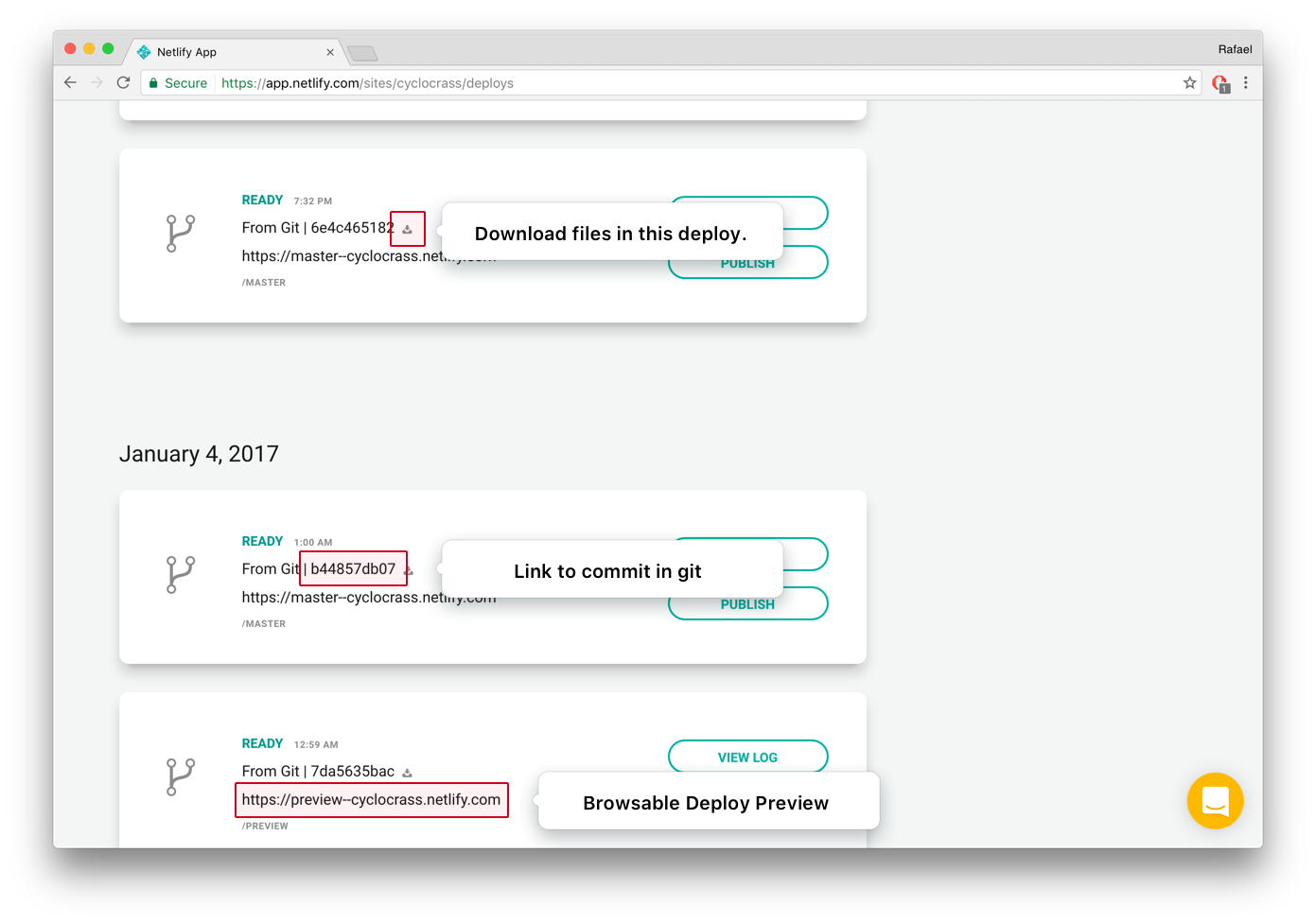

  5. Check out the Deploys tab. Each site has its own Deploys tab in our UI, accessible from the main site settings page. On this tab there are a few things of interest:
  6. build logs. In case a build went wrong, this is a good place to look for information. Those boxes are tiny but you can scroll up and down in them and they also track your build in real-time! No logs for a manual deploy, but there are still
  7. Deploy Previews you (and anyone you tell about them) can browse. Also,
  8. you can revert to a previous build there, or
  9. you can download a copy of any build with the download icon right next to the build. And finally
  10. if you pushed from git, the hash is a link to that commit in your repository!
  11. Apply a custom domain name. We invite all customers to bring a custom domain name, and we provide SSL for your domain name(s). However, before you start, get DNS configured properly and please get in touch in advance if you are migrating a production website that is already using SSL so I can give you some special advice about migrating. Note that in case you use your apex domain (eg: domain.com) we’ll automatically redirect www.domain.com to your site (if you configure its DNS to point to us as well), or vice versa (set www.domain.com as your custom domain, and we’ll automatically redirect domain.com to your site).
  12. Configure SSL. It’s on the ‘HTTPS’ tab of your Site’s settings. This step comes after DNS, and hopefully after your old DNS records’ TTL has expired. TTL is a setting for how long your record can be cached, and that caching interval must expire before we can create SSL certificates for you automatically. Also: Don’t check the ‘force TLS’ option until you are certain that all of your URL’s work with an ‘https://’ in front! Once again I’m happy to help you out if you have any questions or concerns about the process.
