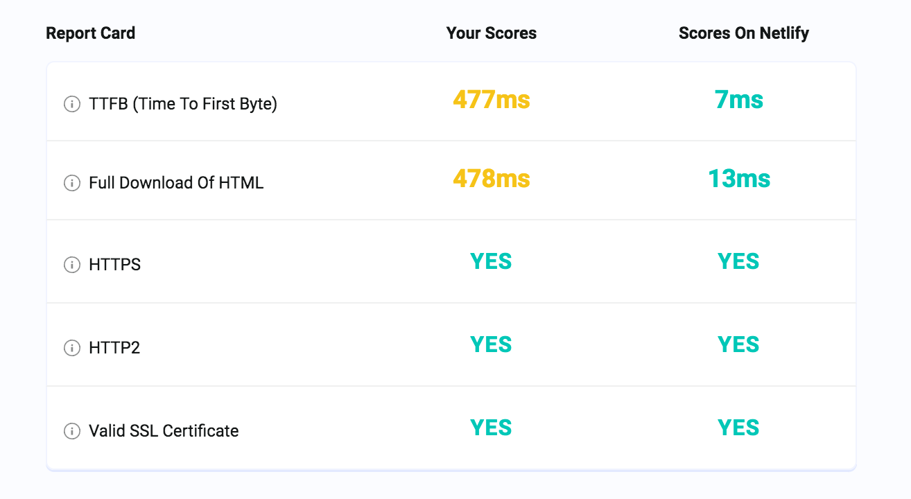

If this is too many steps, Netlify offers prerendering as a 1-click feature. Prerendering is a process to preload all elements on the page in preparation for a web crawler to see it. A prerender service will intercept a page request to see if the user-agent viewing your site is a bot and if so, the prerender middleware will send a pre-cached version of your site with all JavaScript, images, etc. rendered as a static page. If the user-agent is anything but a bot, then everything is loaded as normal, prerendering is used to optimize the experience for bots only.

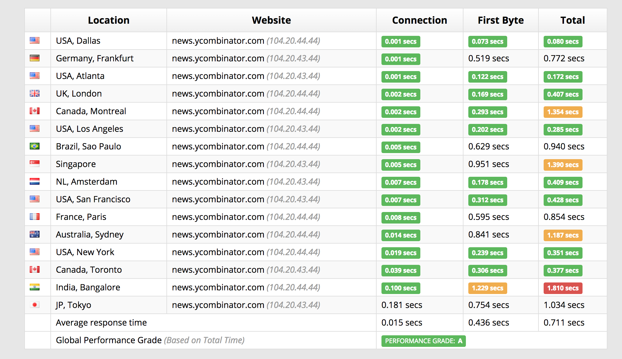

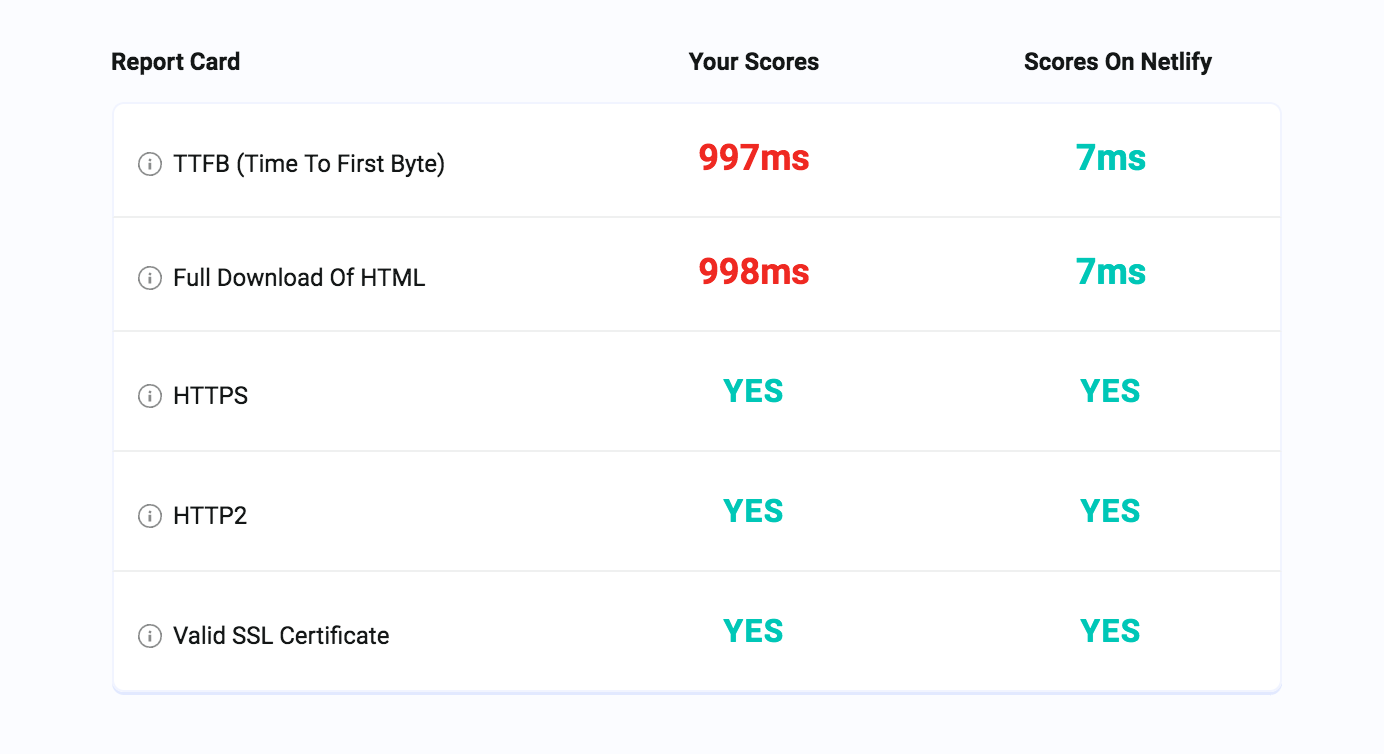

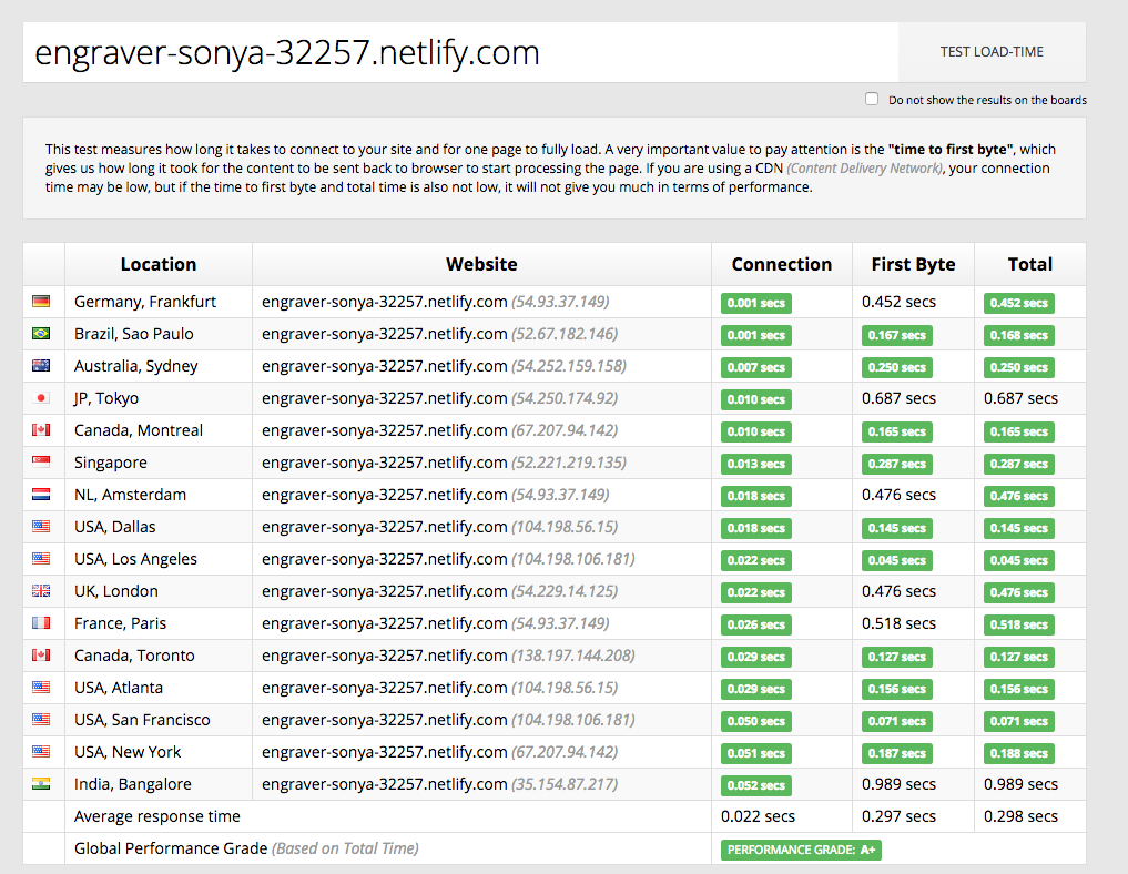

I did some testing myself and compared 2 server-side rendered Hacker News apps to my client-side only and the results are below. The data is fetched the same way in all cases through the Official Hacker News open API. Now consider that these metrics are from sites built by 3 different people using completely techniques, so your mileage may vary. I just am just trying to see if server-side rendering is actually beneficial. Also, please consider that I am not taking into consideration the time for data fetch from the Hacker News API(~70-80ms), my testing is just focusing on first byte, first connection, and full HTML download. I am not focusing on PWA requirements, though I did include the data since it was nice to look at.

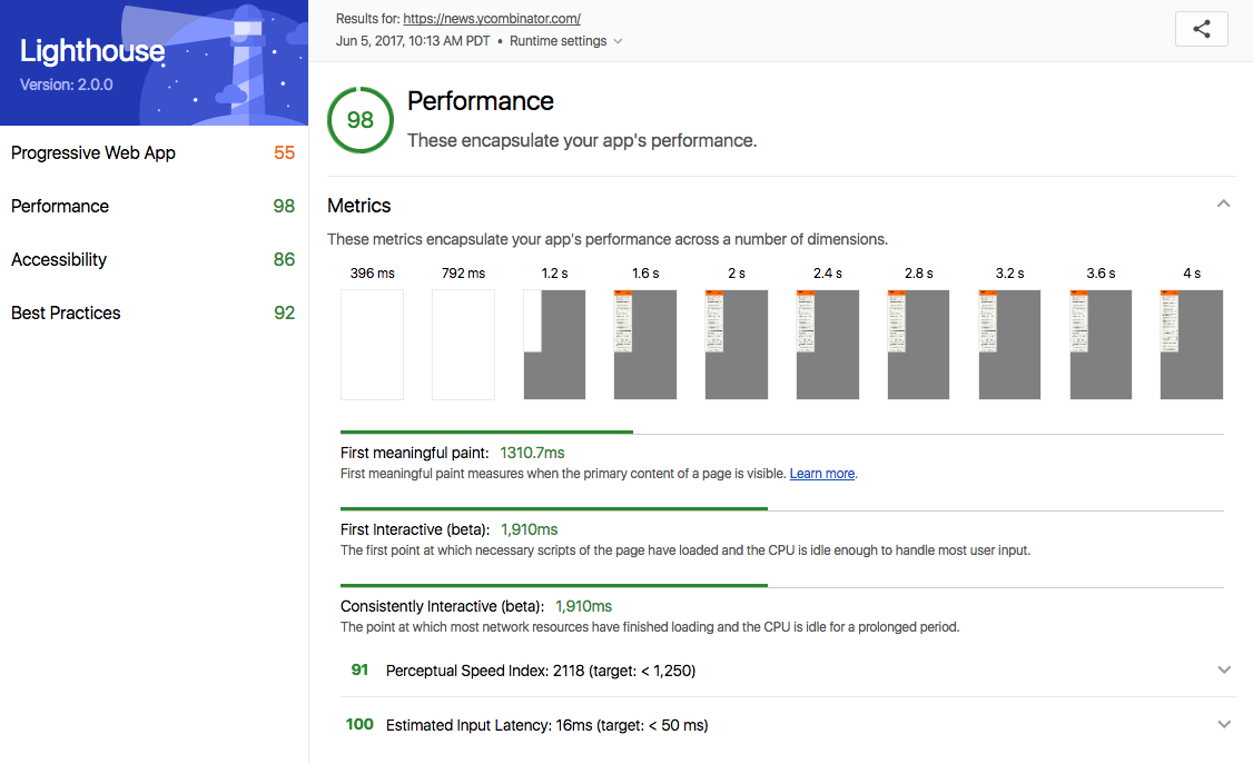

Just for reference, these are the performance numbers for the existing news.ycombinator.com below. I used TestMySite.IO and performance.sucuri.net. These are both great sites for testing how fast your project is delivered to the end user. I also added Google’s Lighthouse, which has a strong emphasis on PWA, not the gold standard yet but interesting to look at.
ycom-sucuri-test ycom-testmysiteio ycom-lighouse-perf
I am not sure of how Hacker News is built, and for this argument, I can assume they are not using JAMstack but indeed using a CDN.

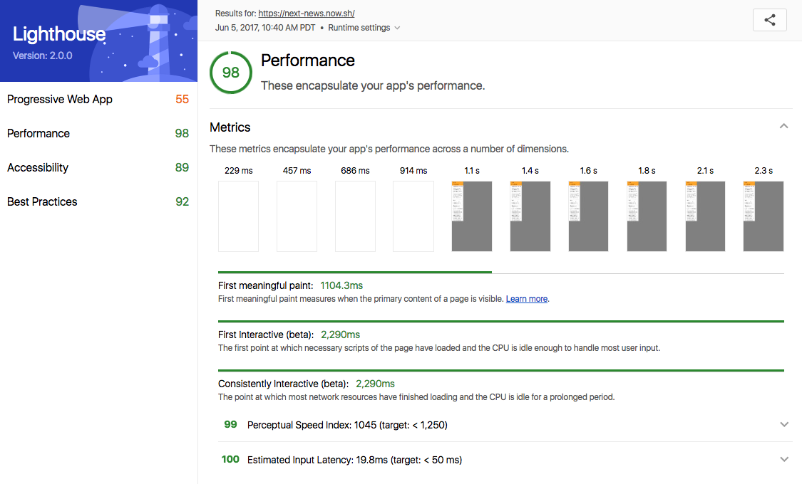

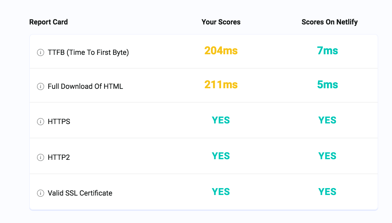

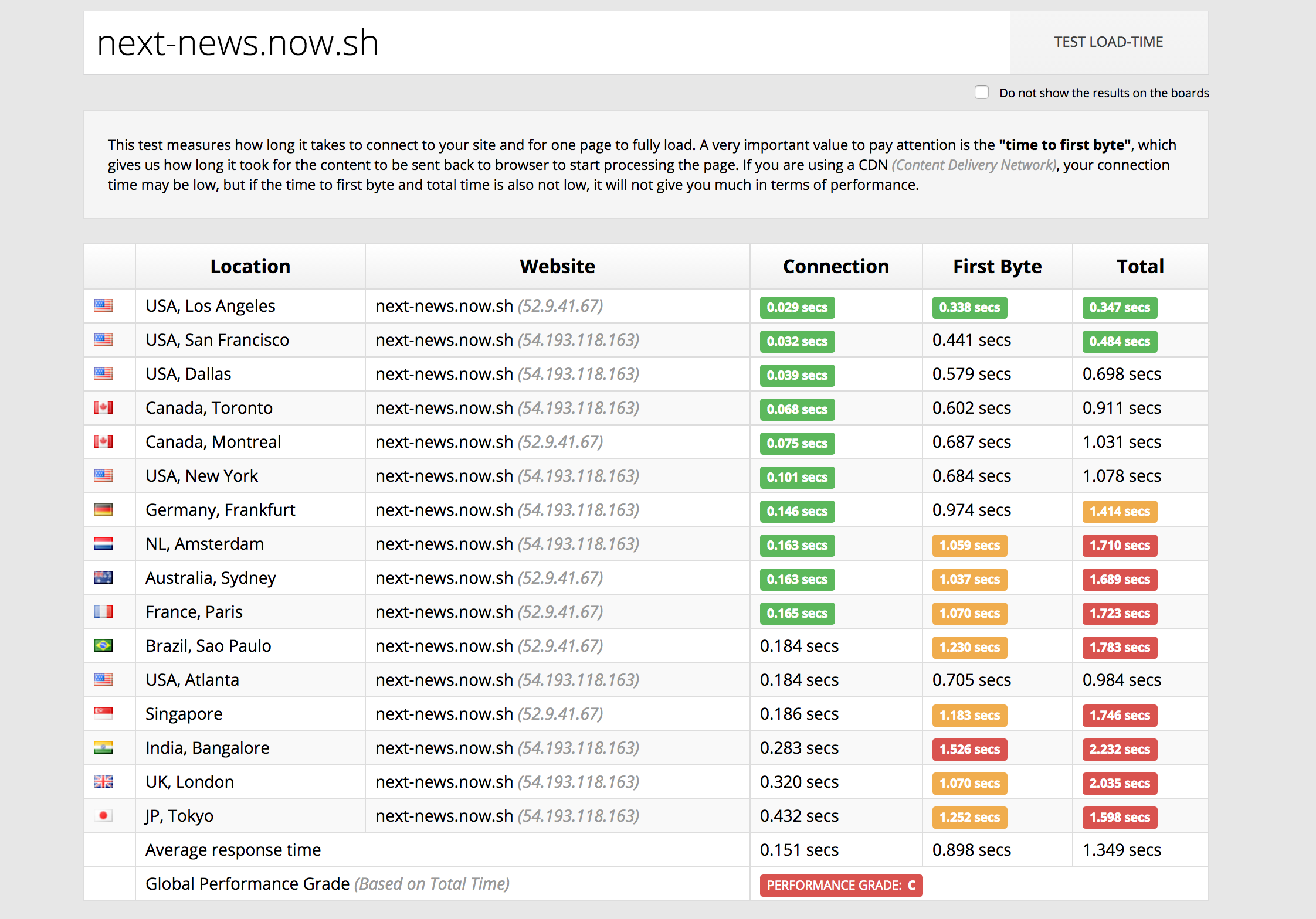

Hacker News clone wth server-side rendering(site, code):
This is a Hacker News clone using a boilerplate:
next-sucuri-test nest-testmysiteio next-lighthouse-perf
It appears that this clone of Hacker News is not performing well outside the US. This is not due to the code itself but actually, the CDN not being global-ready. I am sure switching that will improve the TTFB. I also notice the full download of the HTML is a bit long, most likely due to the initial round trip to the server to fetch the rendered HTML. This is a downside to server-side rendering—a lot of optimization is needed to improve that TTFB. On the contrary this site performs really with the lighthouse performance score, show

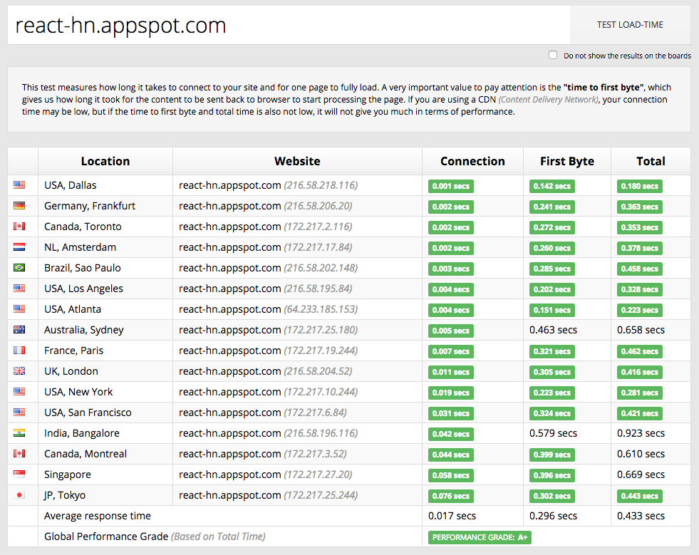

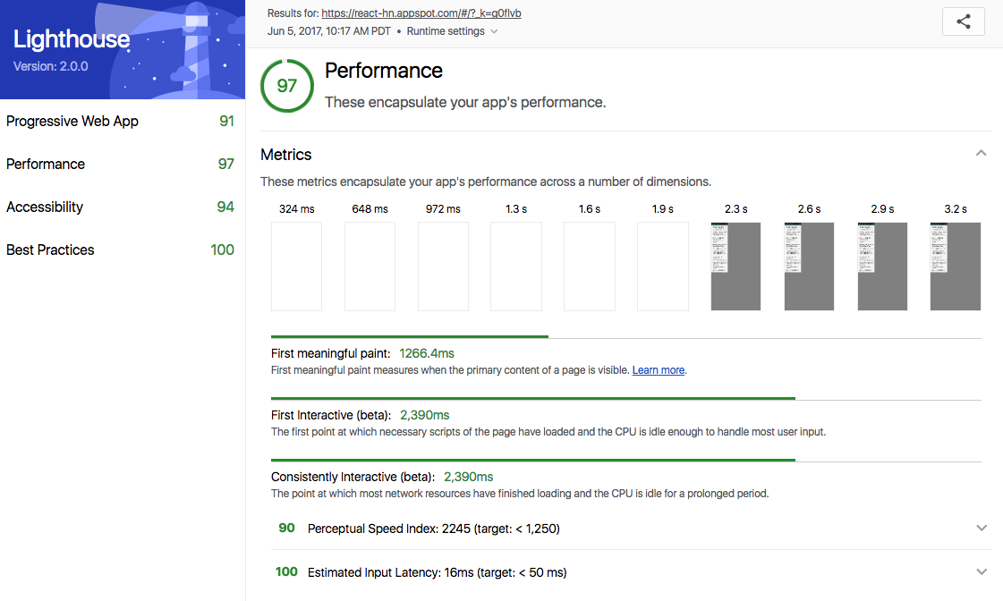

PWA Hacker News clone with server-side rendering (site, code): This is a server-side rendered application. I did notice there are a few commits from Addy himself improving on the PWA aspect of the project to make this site PWA compatible.
reacthn-sucuri reacthn-testmysiteio reacthn-sucuri-perf
This page is also clearly on a global CDN and checks all the boxes for performance in regards to the TTFB. There is not much bad to say about this setup, some of the techniques use for caching are pretty cool to look at.

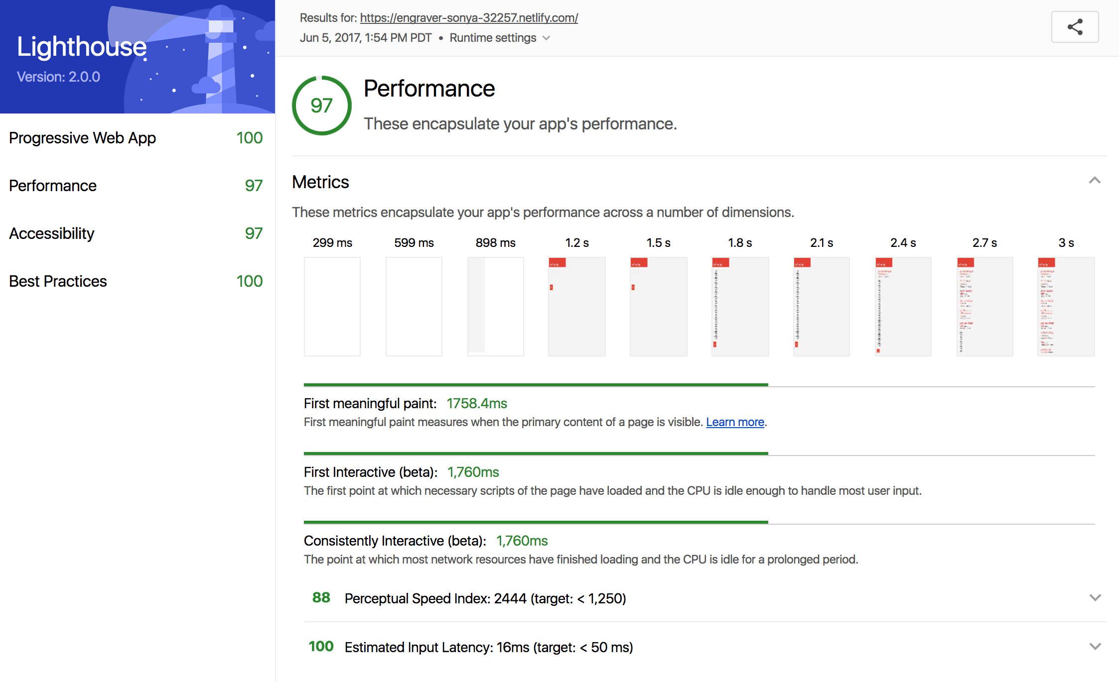

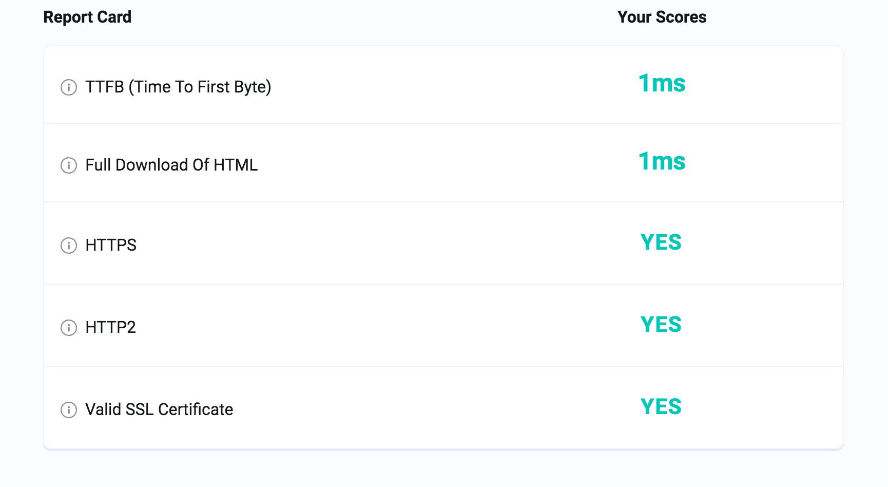

Client-side only Hacker News clone with no server-side rendering (site, code): This is my Hacker News clone. I pulled most of the code from this repo and made very few changes. I am also not taking advantage of any prefetching with service workers, but just relying on Netlify’s CDN and what comes standard from the new create-pwa-app CLI.
hnjam-sucuri hnjam-testmysiteio hnjam-lighthouse-perf
Just looking at the numbers, hosting a JAMstack site on a CDN gets you the best time to the first byte even without consideration for isomorphic rendering. As mentioned above I have plans to improve my Google Lighthouse score by including some of the tricks used in the React-HN app above, but for now, I think this performance will suffice.
It is clear that with little effort and leaving out the consideration to server render anything, I was able to get a site that performs better than most just about as good as the best. This is because I have access to a global CDN that serves content much faster when the request is coming from the same place of origin as the server. If you are not familiar with how CDNs work, I highly recommend this post on the Optimizing Your CDN Strategy for the Ever-Changing Online World.
I also noticed, while improving my Lighthouse score for the PWA rating, my performance went up 4 points on that scale just by complying with Best Practices and optimizing attributes.
