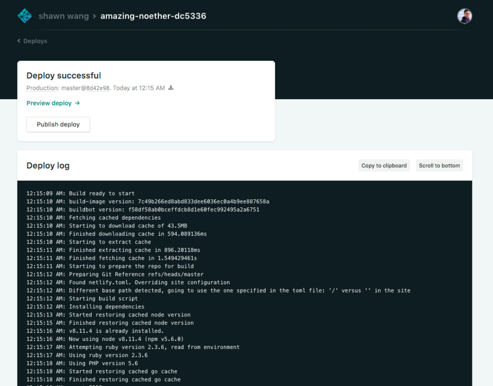

Whenever you trigger a deploy on Netlify (e.g. with a GitHub commit), a new deploy begins with an associated log. It looks like this:
netlify log screen
However there is a known performance problem when logs start being very, very big. You can simulate this by generating an arbitrarily large number of logs by just writing a for-loop with a bunch of console.logs (like in this repo), which looks like this:
