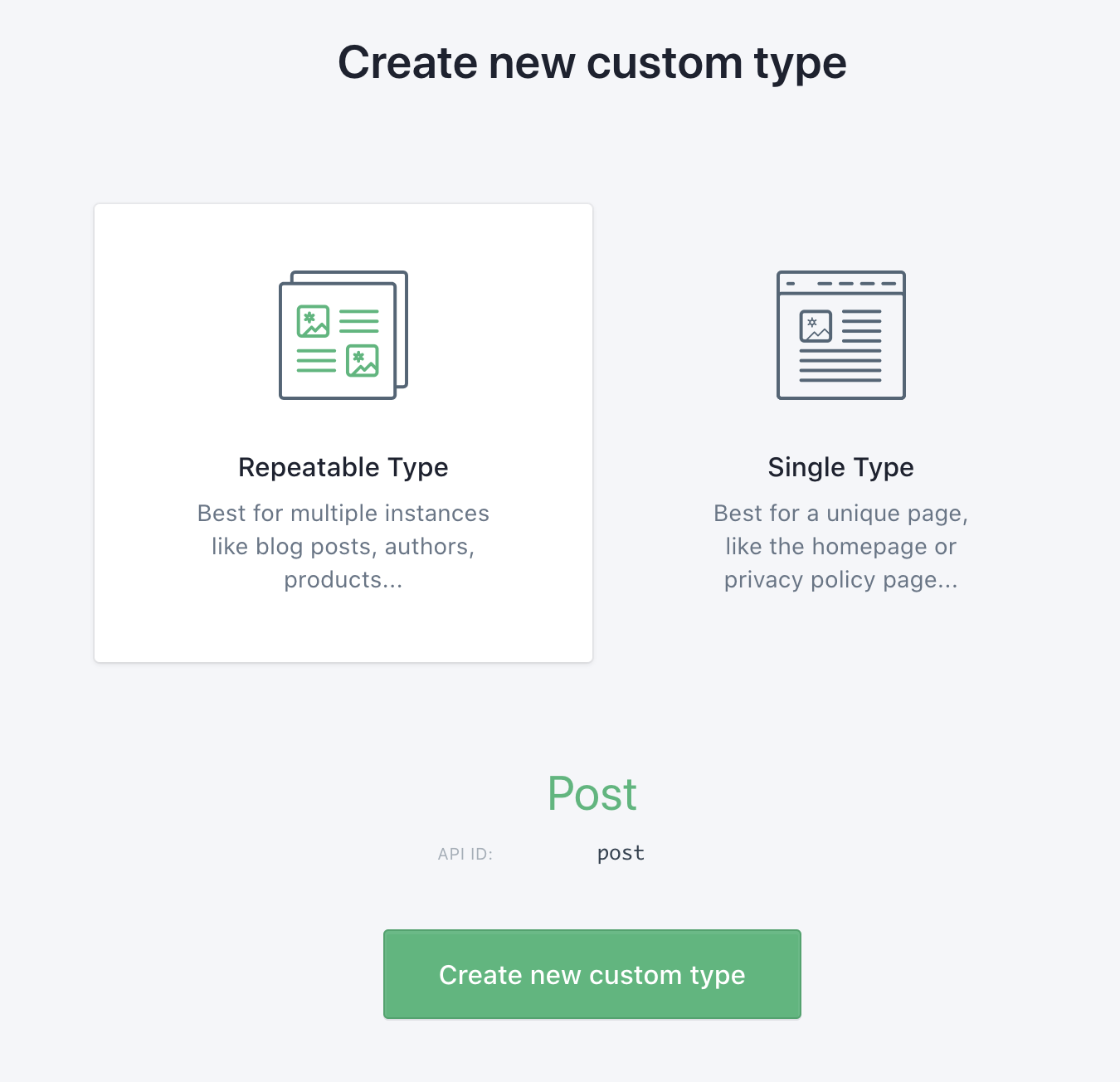

Go ahead and sign up for Prismic, and start a new repository. Once you’ve done that, create a new custom type:
New type of Post

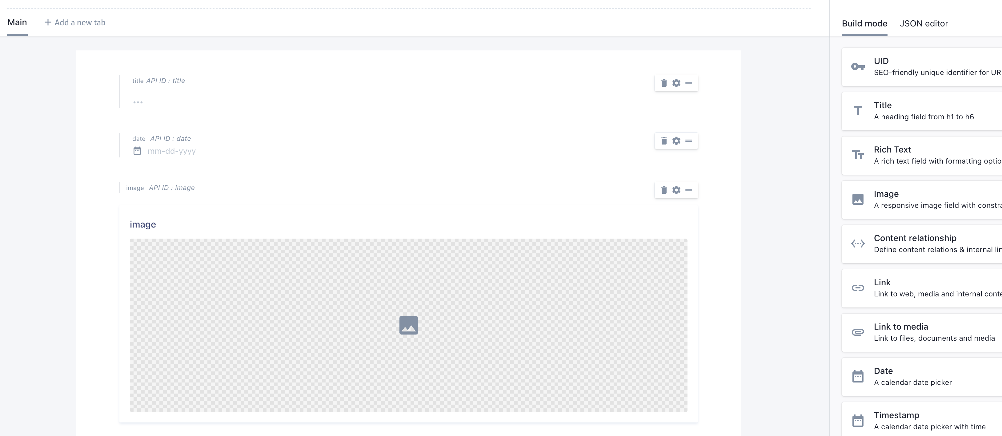

Once you create that type, you can add whatever fields you’d like. I added a Title, Date, and Image:
Post can have custom attributes

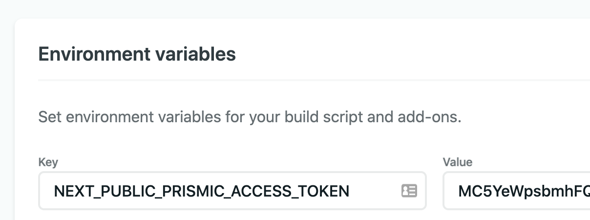

Now that you have a Netlify project, go to your Build & Deploy settings and stick in your access token! Make sure you name it something starting with NEXT_PUBLIC_ so the variable will be accessible in the browser (this is a Next.js thing).
Netlify environment variables

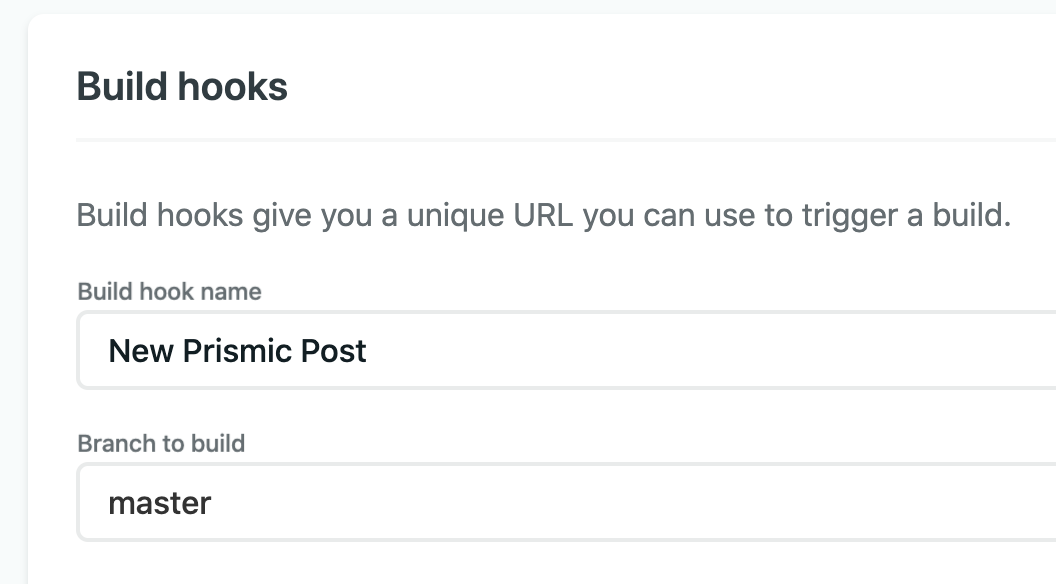

Scroll to the “Build hooks” section here and make a new Prismic hook.
New Prismic Post Build Hook
Copy the URL the UI gives you. We’re going to provide Prismic with this, so whenever you make a new post, it will trigger a site rebuild!

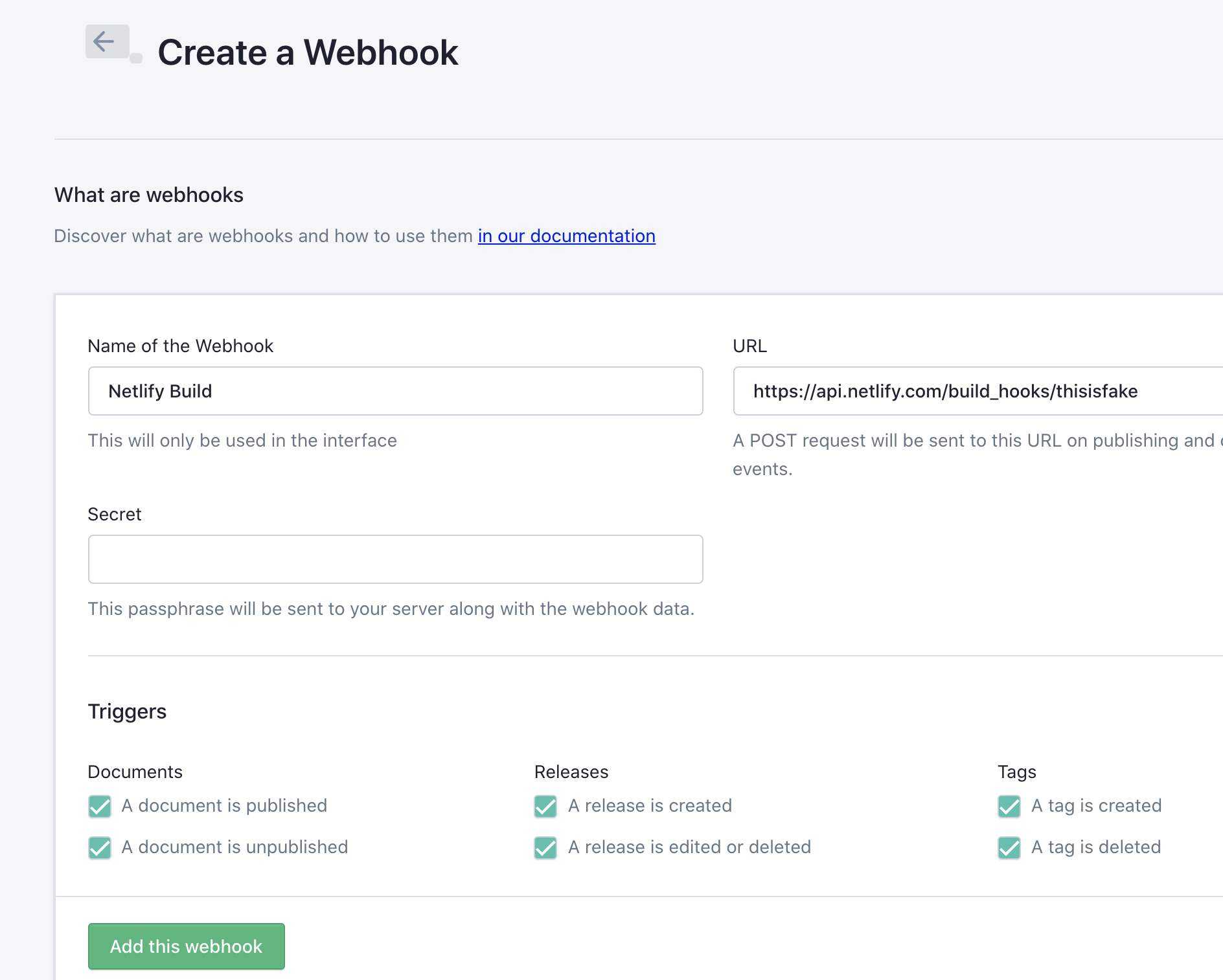

Go to your Prismic settings again, click “Webhooks”, and make a new Webhook. Paste in the URL from Netlify into the form:
Create a new webhook
