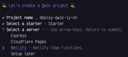

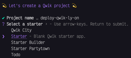

  1. Choose your project type, we are choosing a blank starter app to keep it simple.
Choose the Starter option from the select a starter options

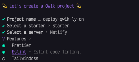

  1. Choose Netlify as your hosting provider.
Choose Netlify from the Select a server options
  1. Select packages you want configured automatically. Eslint and prettier for linting and code formatting, TailwindCSS is an option for styling.
Select which packages you want configured with space bar, prettier, eslint, or tailwindcss.

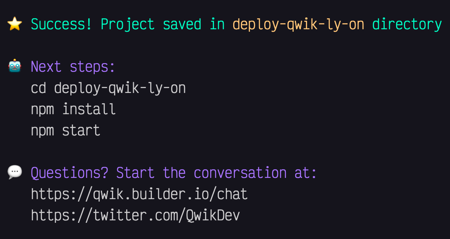

  1. Success! Your Qwik app is created. Follow the next steps to install the dependencies and run the project locally.
Success! Project saved in directory and next steps.

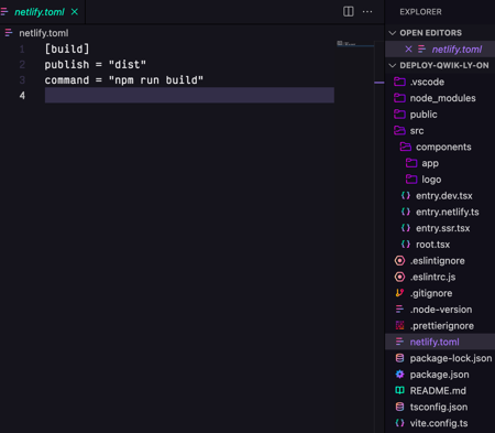

Once through the steps of creating the application and installing the dependencies, you are on your way to deploying the app. If you used the CLI and chose Netlify as the hosting provider, a netlify.toml file already setup for you. If you happened to start here, you can create a netlify.toml file in the root that has the code below in it.
[build]
publish = "dist"
command = "npm run build"
netlify toml file and file structure of Qwik in VSCode

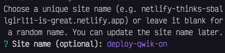

  1. Name your site or leave it blank for a random name. Once this is done, your site is created and your links are available, but the site is not yet deployed.
Choose a unique site name or leave black for a random one.

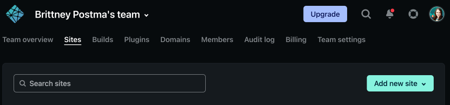

If you choose to do so, you can also manually deploy a Qwik app on Netlify. Once you have a git repository pushed, navigate to the Sites page in your Netlify dashboard and click the button “Add new site”.
Select Sites page from the nav bar

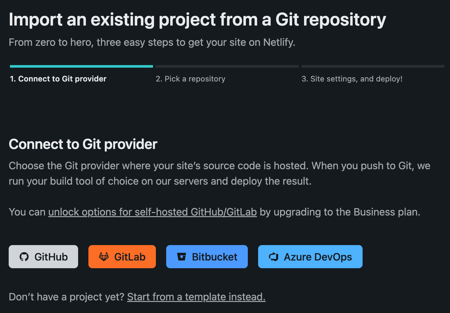

That will bring you to a screen to connect your Git provider.
Connect to your Git provider

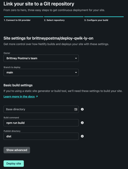

Choose the provider where the git repository for your app is located, then Netlify will authenticate and pop up a search for your available repos. Choose your repository, and Netlify will auto detect the framework and populate the build command and publish directory. If there is a custom build, you can edit the settings on this screen.
Link your site to a Git repository and setup the build settings
Click the Deploy site button and Netlify will begin deploying your application. Now your Qwik app is live!
