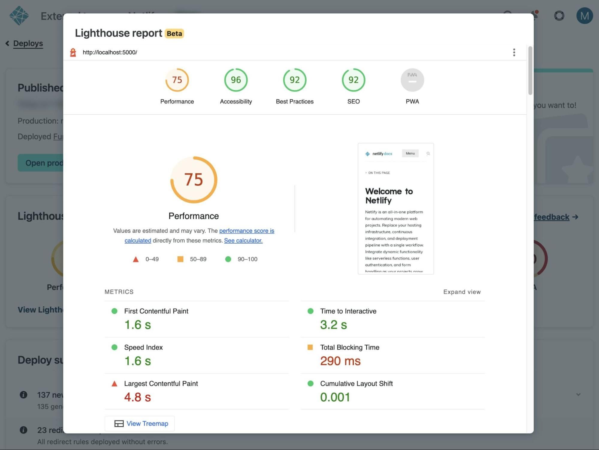

Full Lighthouse reports with scores and web vitals
Prior to this release, you could visualize your Lighthouse scores for each deploy but there was no way to read a full report from the Netlify UI. With this release, Netlify now includes an embedded Lighthouse report with metrics in addition to the scores for Performance, Accessibility, Best Practices, SEO, and Progressive Web Apps (PWA).
Among the metrics available in the report, you’ll find some web vitals included: Largest Contentful Paint and Cumulative Layout Shift. These web vitals metrics are especially important for search engine results.
Use these reports to understand how your performance is improving — or degrading — with each deploy.

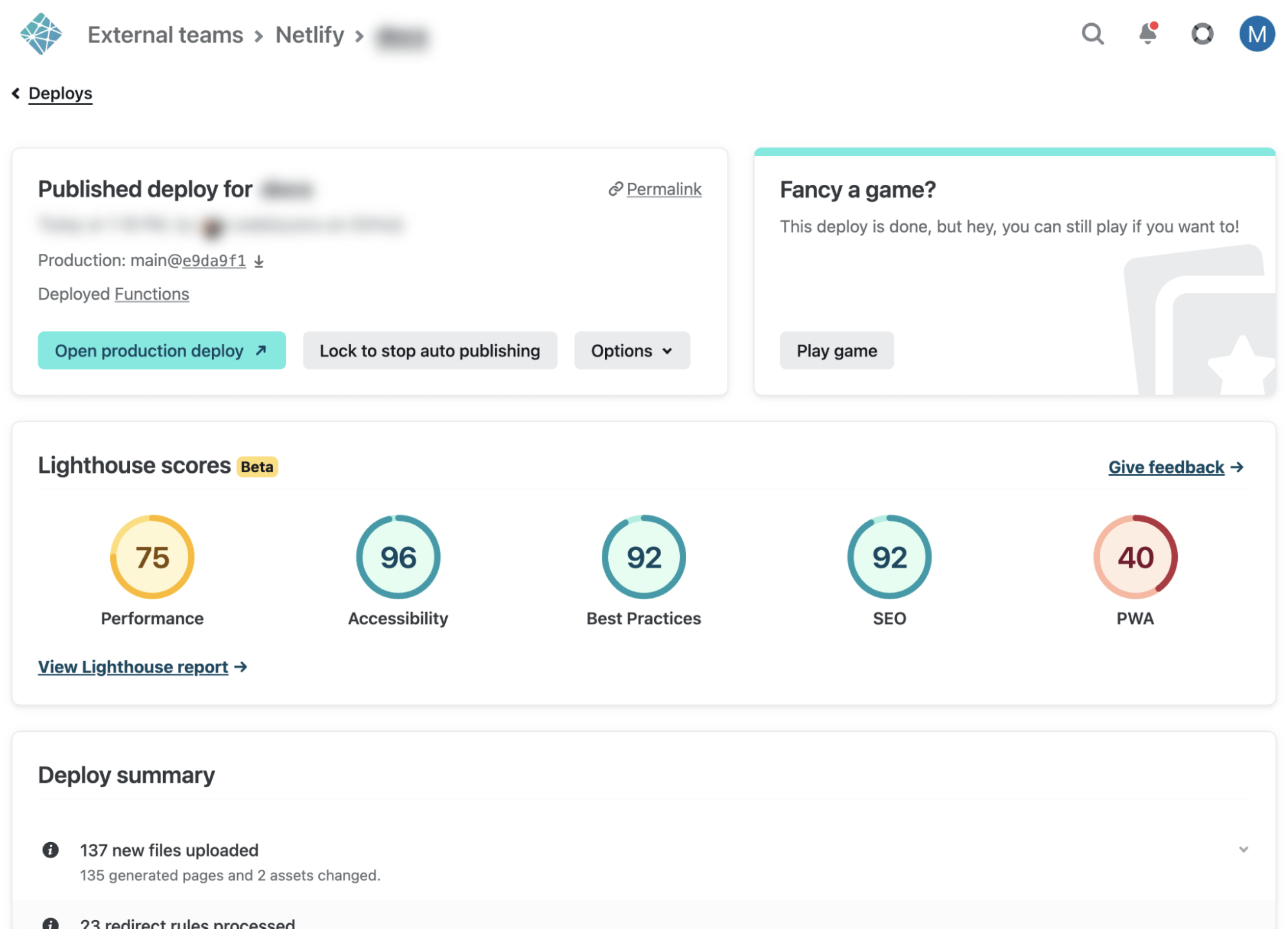

[plugins.inputs.thresholds] performance = 0.9Visualizing Lighthouse scores per deploy
By default, Netlify will show your top-level Lighthouse scores on the deploy page.
Further, if your team is on a Pro plan or above, you can see how the scores have changed over time on the deploy list.
