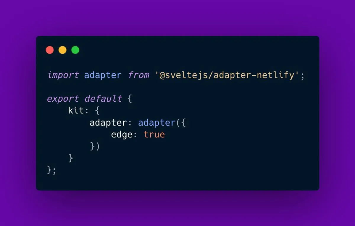

If you’re already building a SvelteKit project with Netlify, enabling Edge Functions is as simple as making a small change to the adapter configuration, setting edge: true.
If you’re deploying a SvelteKit project to Netlify for the first time, you will want to get your project running locally and then use npm or yarn to install the Netlify adapter.
Once the adapter is installed in your project, you’ll update your svelte.config.js file and add the adapter there. While you’re adding the adapter, you can go ahead and set Edge Functions to true.
import adapter from '@sveltejs/adapter-netlify';
export default {
  kit: {
    adapter: adapter({
      edge: true
Finally, you’ll create a netlify.toml file where you’ll specify a build command and publish directory.
