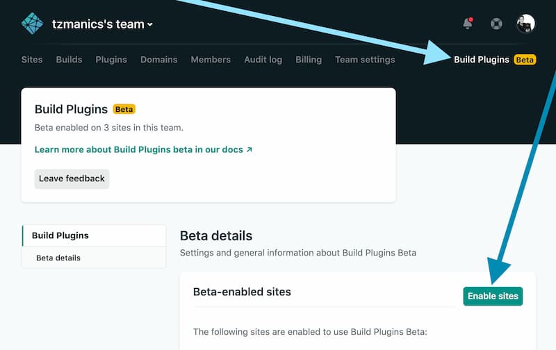

How to Enable Netlify Build Plugins
Let’s get things started with an easy win: enabling Build Plugins for a project. At the top of the team or project page there is a ‘Build Plugins Beta’ button. Click that to head to the Build Plugins page. Here we can find a button that says ‘Enable sites’, pick from our project list and select one or multiple sites. Then click the ‘Enable’ button and they will show up on our list of ‘Beta-enabled sites’.
Screenshot of the UI to enable Build Plugins
