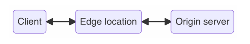

Below is a very simple diagram of a request path:
Request path diagram
To start with, a client makes a request to a page on your website, and the edge location will be the first place where the request starts to be handled.
The best case scenario here is that the edge location is able to fulfill the request in its entirety, and send a response back to the client. But let’s say for a moment that it can’t for whatever reason. Perhaps it needs more information than it has available to it, or a particular service within the cloud provider needs to be used that can’t be accessed from the edge function.
In this case, the edge location will make a request to the origin server where the request will be fulfilled, and a response sent back from the origin server to the edge location. At this point, the edge location has the option to cache the response from the origin server before sending a response back to the client. The caching options available vary by vendor, so doing further research here is highly recommended.
