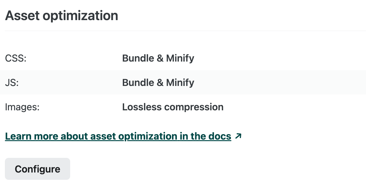

Asset optimization is disabled by default. However, if you’re not sure whether your site uses this feature, you can check in a few places:
- Your site configuration. Go to Site configuration > Build & deploy > Post processing > Asset optimization.

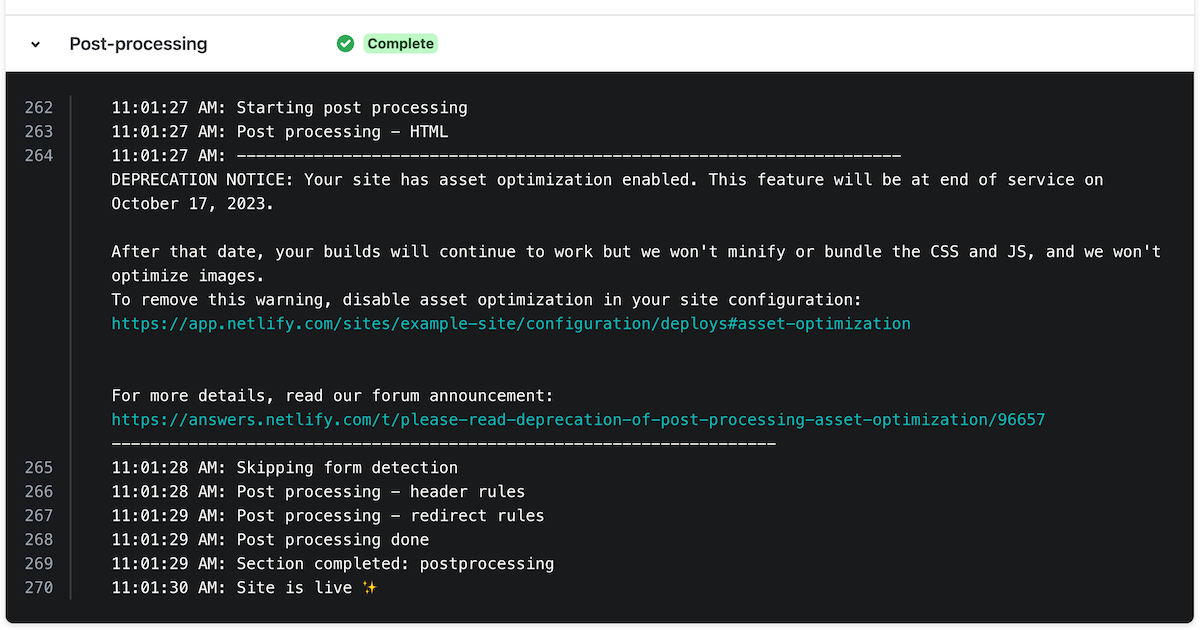

- Your deploy logs. The next time you deploy your site, check for a log line that says:
DEPRECATION NOTICE: Your site has asset optimization enabled. This feature will be at end of service on October 17, 2023.

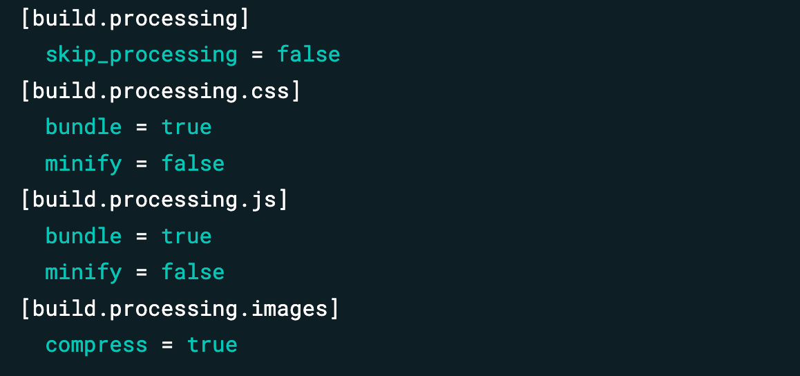

How can I run a test build without asset optimization?
You can run a test build without changing your site configuration by creating a branch and updating your netlify.toml file to include:
[build.processing] skip_processing = trueThis way, you can verify the impact on a Deploy Preview or Branch Deploy before merging your changes to your production branch.
You can be more specific by disabling a different part of the optimization post-processing, as mentioned in the post-processing asset optimization docs. This way you can test and configure options for JavaScript, CSS, and images individually.
